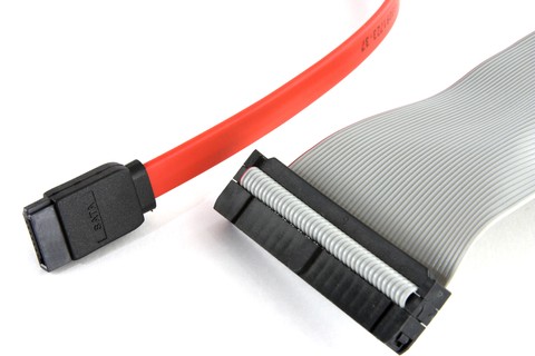

Next, crack its case open, then check the physical cables that connect the hard drive to your USB output. Note: The connections can either be IDE (wider connectors) or SATA (small connectors). Check for any loose cables and make sure that they’re firmly connected.
If it’s not an internal connection issue, try extracting the whole hard drive from the external enclosure, connect it to your computer as a secondary drive, or better yet, via an IDE/SATA to USB adapter.

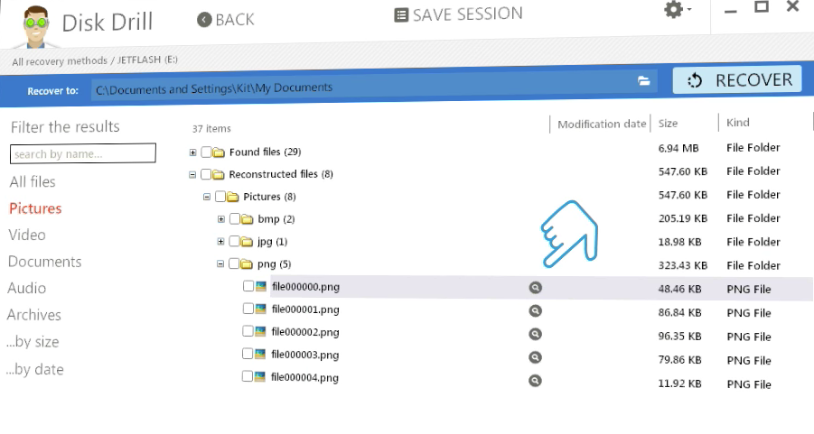

2. Disk Drill
Another free data recovery tool you can try is Disk Drill. This tool has a few different recovery tools you can use, like Quick Scan, Deep Scan and Undelete Protected Data. But, we recommend just clicking the “Recover” button. That will direct the program to run through all of its data recovery options to get your lost data back.
Once you click the button, Disk Drill gets to work. It will scan your drive and show which files can be recovered. Scans can take a little while, so you will have to be patient. You can pause a scan and resume later if it’s taking too long.
Disk Drill will show you the available drives you can scan. Just click the “Recover” button next to the drive to prompt the program to reassemble lost data. You can also use the arrow next to the Recover button to run specific functions like a Quick Scan or a Deep Scan.

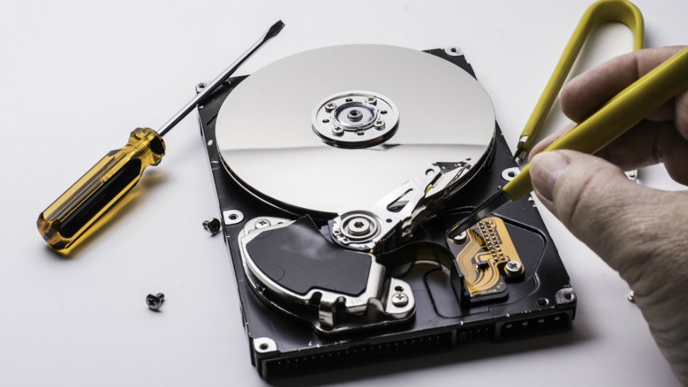

Depending on the severity of the problem, your hard drive may be sent to a “clean room” facility where it is taken apart, and its components (including the platters) are physically examined. These specialized laboratories are kept completely dust-free, critical for delicate electronics.
