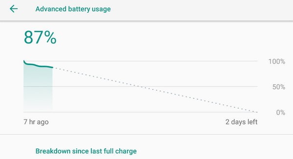

Before you take the step of replacing a battery, head into Settings and tap on Battery. Give the usage details a quick glance and check which apps are using the most battery.
What you’re looking for is any unusual draining attributed to an app. If you notice a particular app is sucking up all your battery, especially if it’s an app you don’t use much, then you might try removing that app and seeing if your battery problems improve.
