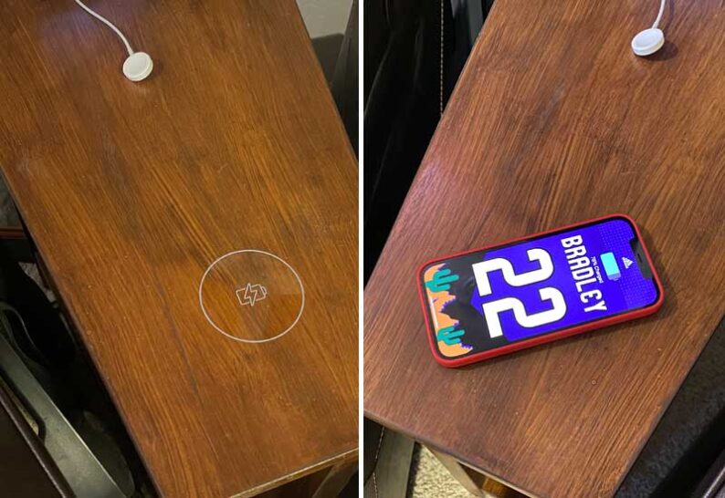

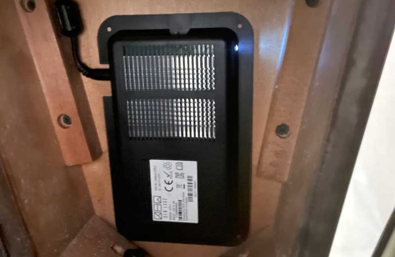

Verifying that your desk or table works is the easy part. Now it’s time for a little trial and error. Pick the spot on the surface where you want to charge your phone, then line up and attach the charger directly underneath. Even if it’s possible to drill small screw holes, it’s much easier to use the supplied double-sided tape to mount it.
Once that’s done, attach the power cord and toggle the tiny switch on the charger to C for calibration. Place your phone on top of the paper template that most closely matches your specific model. Then use both hands to slowly move it over the spot where the charger is located.
The charger will beep more frequently as you get closer to the sweet spot and become a solid tone when the phone is perfectly lined up. That’s where you slap one of the stickers to show where X marks the spot. Then toggle the charger from C to one of two other settings based on table thickness.
Does it work?
Because I didn’t want to attach the charger in a bad spot only to pry the double-sided tape off later, I was probably overly cautious during the installation process. Even still, it only took 20 minutes or so.
And it works … sort of. While the UTS-1 is designed to work with all Qi-compatible smartphones, it has a little trouble with the most recent iPhone 12. Part of the problem is the thicker camera module. But the biggest impact on performance is the MagSafe tech built into the iPhone 12, which has internal magnets that interfere with the charging signal.
And wouldn’t you know it, I have an iPhone 12 Pro Max. While Kew Labs recommends removing the case from an iPhone 12, it still charges mine — but it’s very, very slow.
