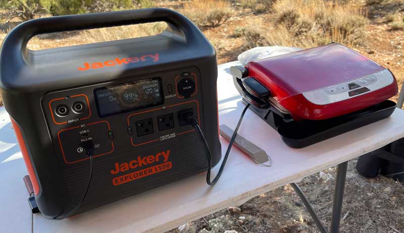

Instead of bringing our portable Weber grill, this time, we opted to bring our more compact George Foreman Grill. Once set up, we plugged the grill into the power station and pushed the button to activate the power outlets. The display on the grill lit up immediately.
Cooking burgers at 400 degrees for 15 minutes drained about 25% of the Jackery’s battery. Then using it to charge our phones and a Bluetooth speaker, we eventually got the power station’s battery to around 50%. Time to break out the solar panels …

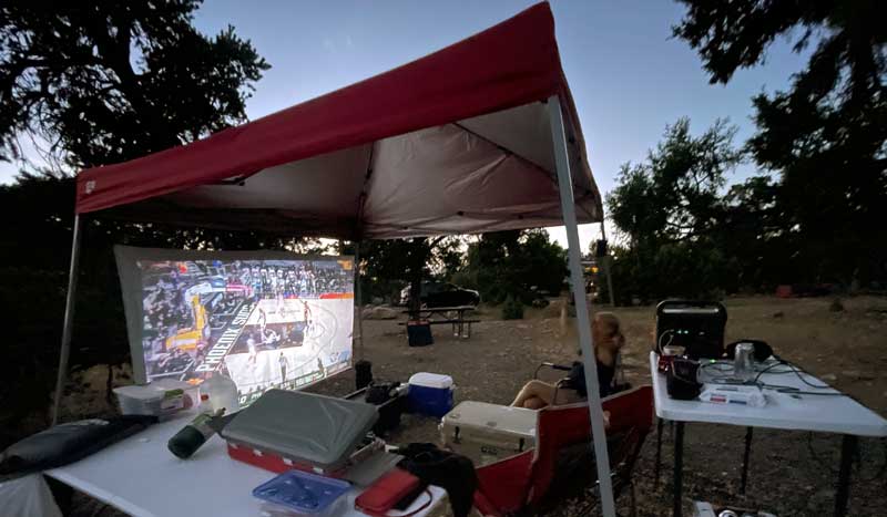

I wasn’t going to adjust our plans, but I also did not want to miss the first game in the series. So I added a little home theater next to our tent. Here’s all it took:
  • 10’x10′ canopy
  • 100″ projector screen
  • Mini projector
  • Apple TV
  • iPhone (as the hotspot)
  • Jackery 1500 Explorer to power it all
It was a pretty easy setup, and my only concern was having enough cellular service to stream the game live. Somehow, the 3G signal at the campsite was good enough.
This was definitely a unique situation, but the setup would not have been possible without the Jackery power station. It worked out so well that we also brought along a Blu-ray player and watched “Avatar” later that night.
