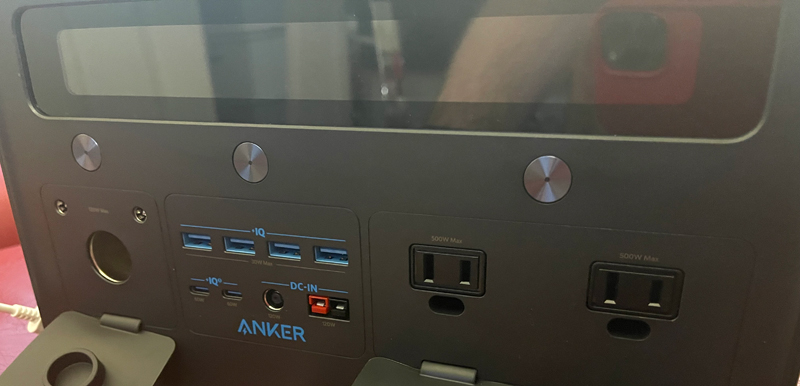

The Anker PowerHouse II 800 is a portable power station with some pretty impressive specs for its relatively small size. Here are the highlights:
- 777 watt-hours
- 2 AC outlets
- 2 DC outlets (including specialized “Anderson” ports)
- 2 USB-C ports
- 4 USB-A ports

On the front, you have a nice, large LCD showing charge percentage remaining in the center along with input/output metrics on either side. Right below the screen is three power buttons for AC, car and USB ports.

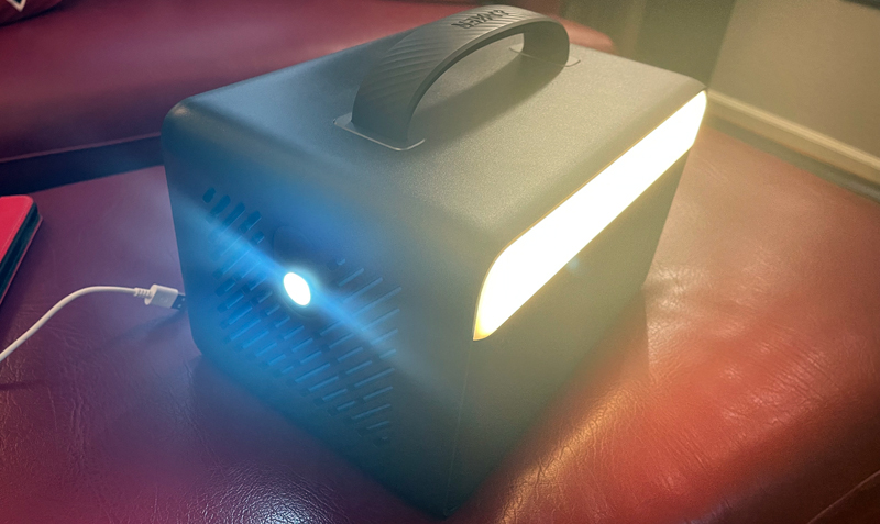

Look to the right side of the power station and you’ll find a built-in flashlight. Push once for low, twice for high, three times to strobe and a fourth time to turn it off.
On the back, another light. This is more of ambient light like a lamp and has three brightness settings that you could use during a power outage or at a campsite.
