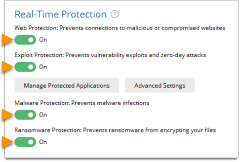

If you have Malwarebytes Premium, you can disable its ransomware protection tool. Some people have reported this fixes Windows 10 compatibility issues that they’ve run into.
How to disable Malwarebytes ransomware protection
  • Open Malwarebytes Premium.
  • Click Settings, then click the Protection tab.
  • Under Real-Time Protection, you will see four protection layers.
  • Toggle the switch to the left under Ransomware Protection to disable the tool.
  • A User Account Control menu will appear asking, “Do you want to allow this app to make changes to your device?” Click Yes to confirm changes.

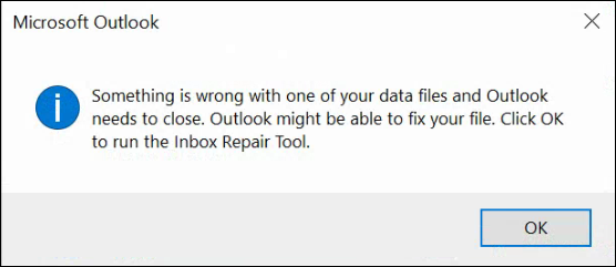

Here’s what’s happening: According to Microsoft, after updating to Version 2005 Build 12827.20268 or higher and starting Outlook, you may see the following error prompt:
“Something is wrong with one of your data files and Outlook needs to close. Outlook might be able to fix your file. Click OK to run the Inbox Repair Tool.”
Microsoft
But, here’s the problem. If you click OK to run the Inbox Repair Tool, the problem doesn’t go away. You just end up in a never-ending loop of madness as the same message keeps coming back over and over again.

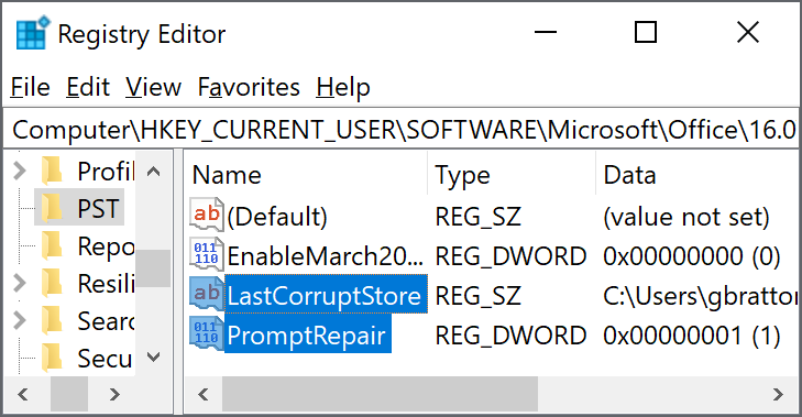

Microsoft says an initial client fix is available in Insider Beta version 13004.10000. It’s not sure if the primary fix will come from its Outlook Team or Windows Team, but in the meantime, there is a workaround you can incorporate.
But, proceed with caution! Microsoft warns that this workaround means you’ll need to modify the registry and if it’s done wrong, it could cause major system problems. That’s why it’s critical to follow these steps exactly and it’s a good idea to back up the registry before continuing.
How to workaround the latest Outlook issue:
  • Right-click the Windows Start button and then choose Run.
  • In the Open box, type regedit, and then select OK.
  • In the left pane, expand Computer and then expand HKEY_CURRENT_USER\SOFTWARE\Microsoft\Office\16.0\Outlook\PST
  • Under the PST key delete the registry keys below and then restart Outlook:
    • “LastCorruptStore”=”C:\\Users\\user.REDMOND\\AppData\\Local\\Microsoft\\Outlook\\*** Email address is removed for privacy ***”
    • “PromptRepair”=dword:00000001
